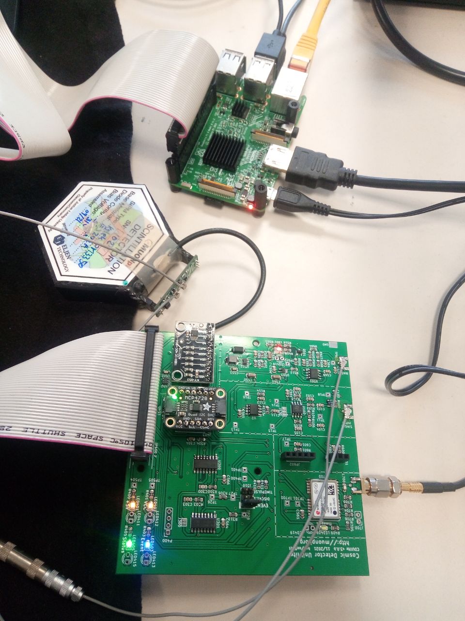

After arrival of the partially assembled pre-series Lite boards after X-mas, I soldered the remaining components to obtain one complete board for testing. Assembly was a piece of cake due to the possibility to simply plug in the ADC and DAC components through the corresponding breakout boards available from online vendors (e.g. https://learn.adafruit.com/adafruit-mcp ... c-quad-dac and https://www.adafruit.com/product/1085). It turned out, that obviously everything is well designed and working as it should :) Thanks again to Christian (OE5HCL) for this superb piece of hardware.
The attached photograph shows a lab setup of a detector operated with the first Lite board. The rpi connects to the board with a standard 40-pin (female-female) jumper cable.
Series mounting of the remaining 29 boards of this pre-series batch will start shortly and first detectors featuring the Lite version will be shipped soon.
