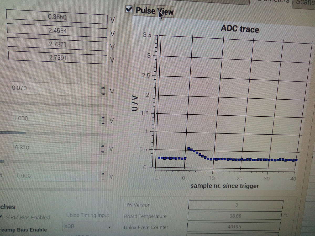

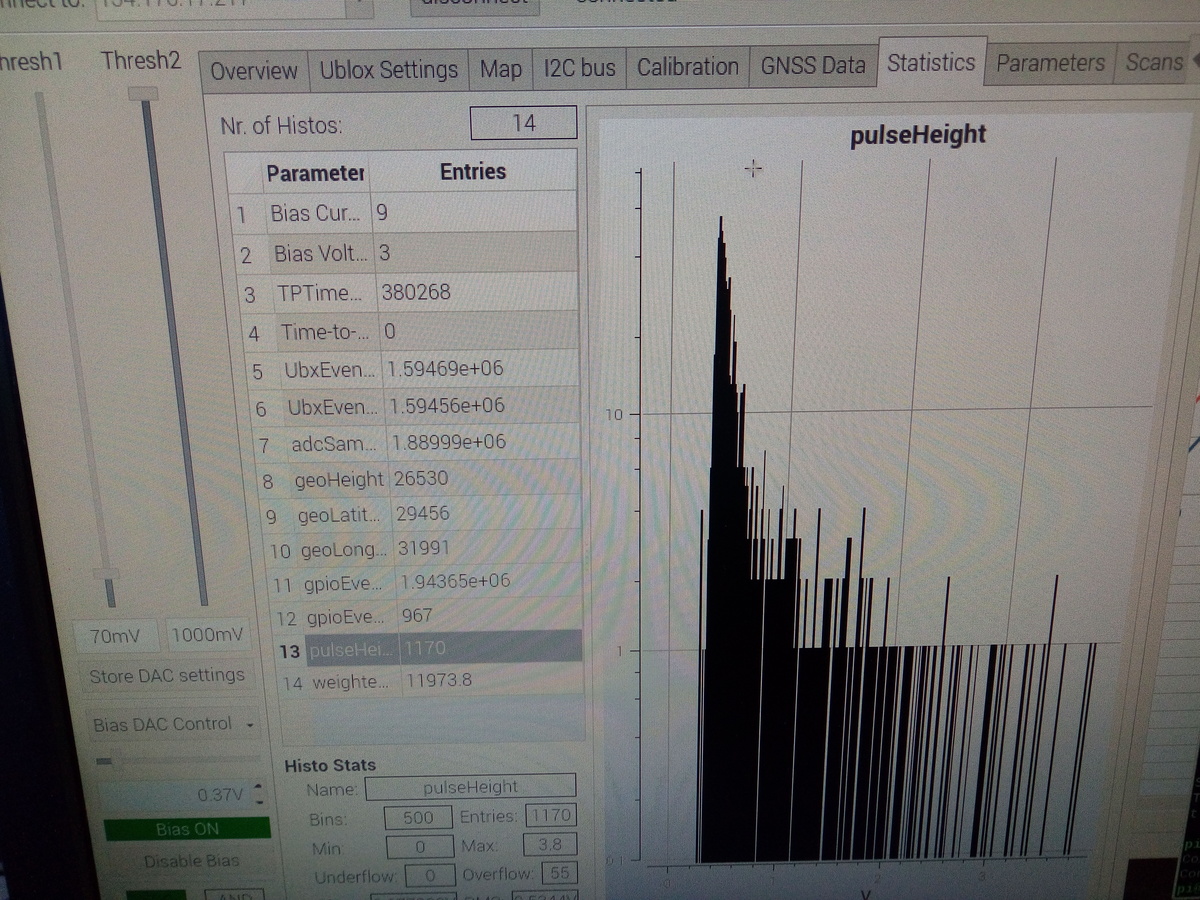

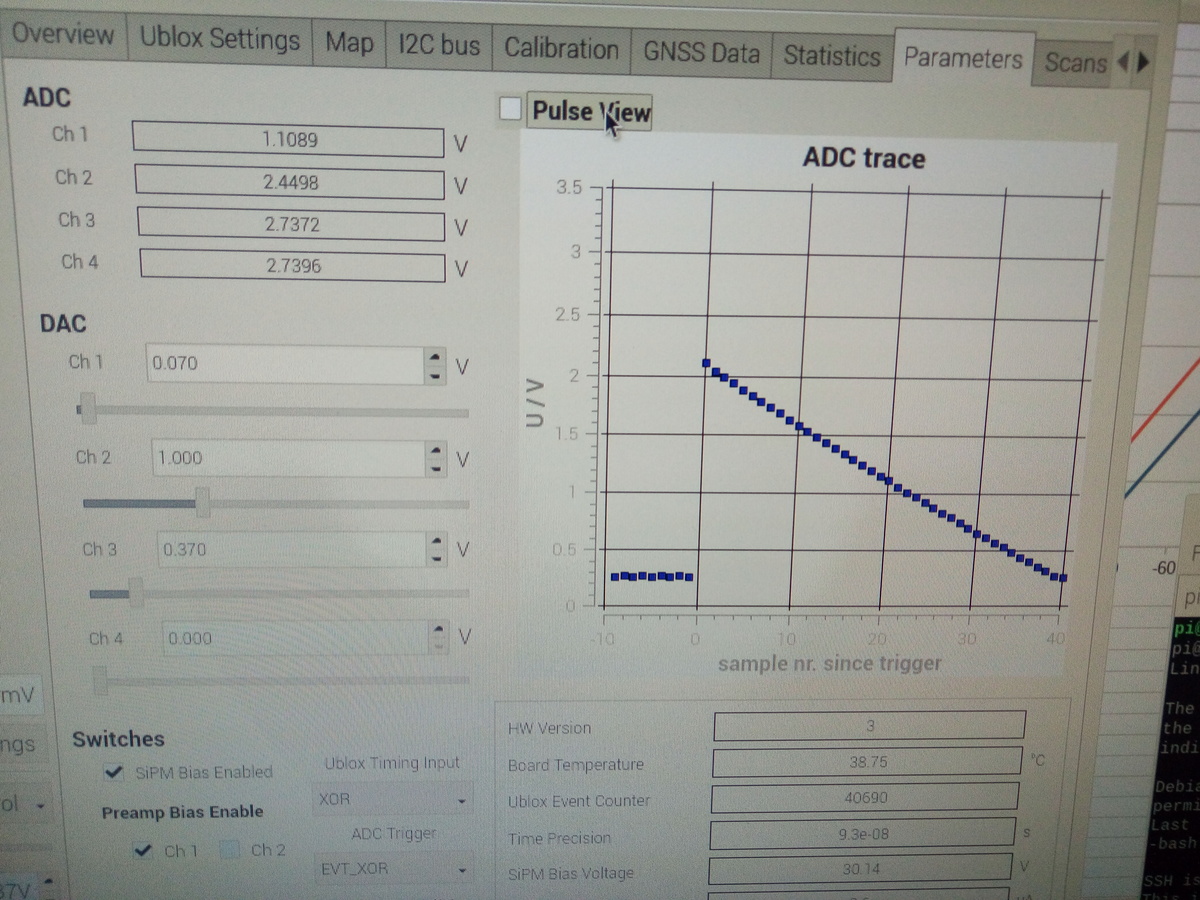

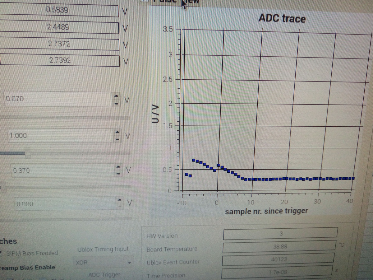

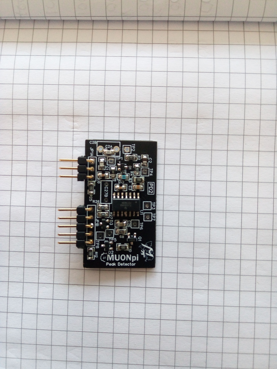

Hi all,
I just mounted and tested the new version of the plug-on Peak Detector module (PD2) for the amplitude measurement of the muon signals. Still not pleased with the performance, but energy loss spectrum as recorded and displayed in the GUI (see photos) seem to be plausible. The focus will now move to the optimization of the dynamic range and the droop of the peak-hold stage.
